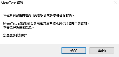

作者: strikewinghk    時間: 2020-4-15 18:32     標題: MemTest 出現以下問題
Memory Error Detected!
A number was written to memory, and when that same location was read back after some delay, a different number was found.
This is not normal. Your RAM is bad, or your system is incorrectly configured. Even just one error means that you have a problem. If you have overclocked your machine, or selected aggressive RAM timings in your BIOS you should try more conservative settings before judging the RAM fully bad. If you can't get MemTest to run without errors even with conservative BIOS settings, however, your RAM is the most likely cause. Correctly functioning RAM has no errors, even if you run MemTest for days.
係咪條RAM死死地,要試邊隻要單條RAM行機試?
作者: strikewinghk    時間: 2020-4-15 18:35
索引.jpg 行2000%出2次呢個野
圖片附件: 索引.jpg (2020-4-15 18:35, 19.49 KB) / 下載次數 123
https://h1.hkepc.com/forum/attachment.php?aid=2187325&k=2bfdfb2b83aec76b811f74f5dad4ff78&t=1781367966&sid=2NzaB2Em4F
作者: Lightersiu    時間: 2020-4-15 19:00
係咪超得太盡
作者: strikewinghk    時間: 2020-4-15 23:03
4000 行15-15-35,見佢今日未藍面先試MemTest
作者: lkl0120    時間: 2020-4-16 02:36
2000%又多咗少少,唔洗試到咁盡
試500%就夠
如果試到2000%先出ERROR都唔洗太介意
日常用唔會出事
作者: wann    時間: 2020-4-18 22:46
2000%實在多左d。我通常100%過到就當成功,可用
