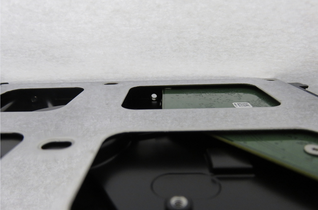

作者: Kennn    時間: 2016-5-6 19:01
作者: pc1668    時間: 2016-5-6 23:11
其實金屬架會唔會怕有機會會shock倒個硬碟底?
Kennn 發表於 2016-5-6 19:01
hmm...just don't know about that.  However, it seems the plastic tray of unitek das is quite anti-shock.
作者: Kin_2012    時間: 2016-5-7 01:19
回覆 24# Kennn
怎麼可能
圖片附件: H.jpg (2016-5-7 01:19, 139.17 KB) / 下載次數 53
https://h1.hkepc.com/forum/attachment.php?aid=1887090&k=e82fd08c435e5c074853e38021296e38&t=1781899163&sid=57XfbjYx9e
